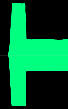

Before AGCAGC output
Piece of audio before and after AGC. The output signal (bright green) is much more constant in volume than the input signal.

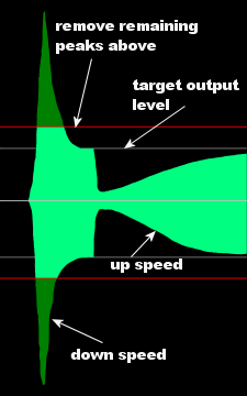

  • Band 1+2 upspeed
    Determines how fast the volume level is increased when the output level is below the AGC Target output level.
    When the output volume has been lowered due to too loud sounds, this slider determines how fast the output volume can be increased again. A higher value means that the average output level gets closer to the target level, but may also cause pumping. A low value may cause source material with big volume changes to come out too soft on average - and the quieter parts will stay very quiet.
  • Band 1+2 downspeed
    Determines how fast the volume level is decreased when the output level is below the AGC Target output level.
    When the output volume would be louder than the set maximum AGC Target output level, this slider determines how fast the output volume is reduced. A higher value means that the average output level gets closer to the target level, but may also cause sudden volume drops when very short loud spikes occur. A low value may cause spikes to remain when the sound suddenly increases a lot. See Spikes (and also the no longer advised Remove remaining peaks above) for a solution for that.
  • Remove remaining peaks above
    Removes short volume spikes that remain at the end of the AGC processing.
    Superseded by Spikes, use that instead for better results.
    The AGC responds slowly to volume changes, to keep the effects on the audio as small as possible. This does mean that if the volume suddenly increases a lot, a loud 'spike' of sound can remain. This slider determines how much 'spike' is allowed above the configured Band 1+2 upspeed; anything louder than that is reduced.
    If this slider is set too high, loud spikes remain; if it is set too low, too much spikes are removed, which takes out 'kicks' from the audio, making it sound too 'flat'.
    If this setting causes peaks to be removed, black bars are displayed in the output bars at the bottom of the window. Ideally, these should only occur when they are needed (sudden volume jumps), not during 'normal' music (like every bass kick).

Speeds panel
Attack, release and ratio.
These are standard settings that almost every compressor has.
  • Ratio
    Determines how strongly the compressor responds to changing input levels.
    Say, at one moment a sound comes in at the threshold level, so nothing happens to it. If another sound comes in at 6 dB above the theshold level, the input should be reduced by half. The ratio indicates how much of the increase in input level is not removed. At a the lowest ratio (1:1), the compressor is basically disabled. At the maximum ratio, 1000:1, 1/1000th of the increase is kept.
  • Attack (time to drop 86%%)

  • Release (time to raise 10 dB)
    The time it takes for the output level to climb by 10 dB if the input level falls silent.
  • Release hold time
    Time for the 'brake' on the release to fade out.
    When attack has been active, release is not immediately activated to avoid excessive movement. Instead, the release is held back for a while. This slider determines how long.
