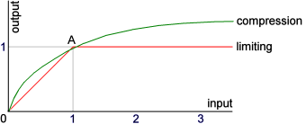

Reduces the dynamic range of the audio and limits it, using a configurable number of bands.
Volume compression (A.K.A. audio level compression) reduces the dynamic range of a sound. This means that loud sounds become softer, and soft sounds become louder.
Limiting limits the maximum audio level below a certain threshold.
For a lengthy discussion about compression, see Wikipedia: Audio level compression.

  • Limit <--> Compress
    Determines whether the audio is compressed or limited.
    Limiting means that audio below a certain volume is left untouched. If the volume gets above this level, the output volume is lowered such that the resulting output stays at the set maximum volume (Band {} soft limit).
    Compression affects all audio: Low volume sounds are amplified, high volume sounds are de-amplified.
    In general, when the goal is to make the volume as constant as possible, use limiting. If the goal is sound quality, maintaining dynamics, use compression.

    • Band {} soft limit
      The target maximum output level for this frequency band.
      For each band, how much of the output volume range may be used before the amplification must be turned down.
      This is the value A in the graph above.
