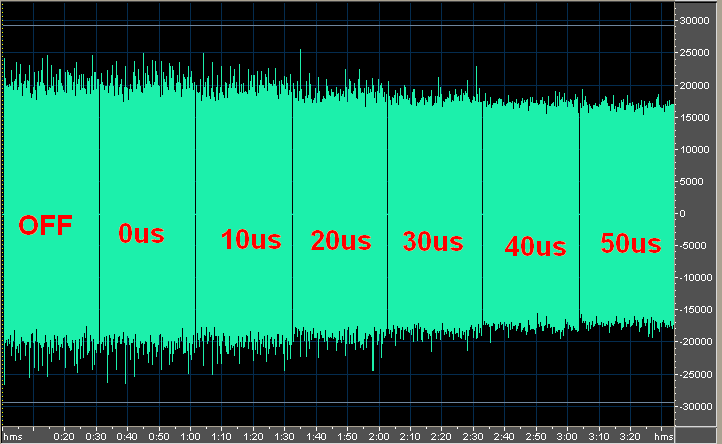

Prepare for lossy compression (MP3/AAC/OGG/...) panel
Protects the output against overshoots when using lossy compression (MP3 etc.) on it.
If you compress the tightly clipped output of Stereo Tool with a lossy codec such as MP3, AAC, Ogg, you will notice that you get spikes again. This is caused by the fact that almost any change in the tightly clipped signal will cause it to be less tightly clipped. To avoid getting distortion, you need to lower the output level.
But because differences in the signal occur much more in higher frequency ranges, it helps to boost the highs a bit before clipping, and lowering them again afterwards.
This graph shows the effect of different settings on a 128 kbit/s MP3 file.
Lossy Compression affects Advanced Clipper and Hard Limit output.
  • Pre-emphasized clipping/limiting (MP3/AAC/OGG/...)
    Turns pre-emphasized limiting and clipping on.
  • Pre-emphasis time
    Pre-emphasis.
    The amount of pre-emphasis to use before, and de-emphasis after, clipping.

    Selects between clean highs and constant volume levels.
    High frequencies can get extremely loud due to FM Pre-emphasis. With this slider, you can choose if you want to keep the volume of all other sounds constant (low values), or if you want loud highs to be able to push other frequencies down. That allows the highs to sound brighter, but pumping caused by loud highs is very annoying in music.
    If you are using Composite Clipping, higher values are less problematic, because highs are less problematic.
